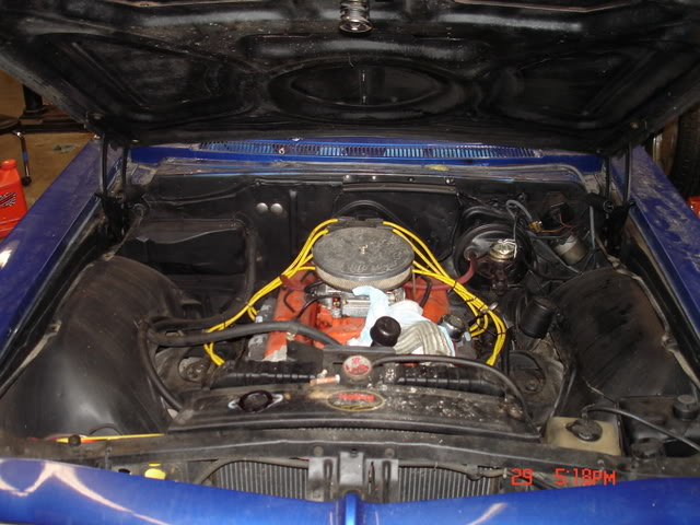

i mean COME ON..... LOOK AT ALL THIS SPACE UNDER THE HOOD.....
and thats a 400cubic inch motor from my dads old suburban i had the original 327 burning oil and never had the cash to have the heads completly rebuilt
maybe one day i will.....
but with all that space under these hoods JUST THINK ABOUT WHAT YOU COULD FIT UNDER THIER
maybe one day i will.....but with all that space under these hoods JUST THINK ABOUT WHAT YOU COULD FIT UNDER THIER
