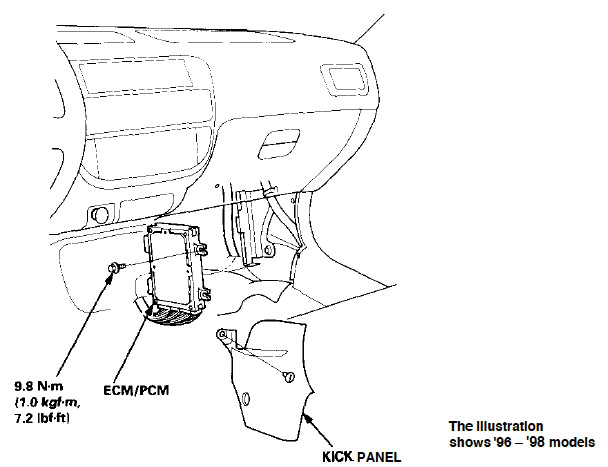

All you do is buy a replacement, disconnect the battery for 15 minutes or so, unplug the old ECU, plug in the new one, and reconnect the battery. You should be good to go.
