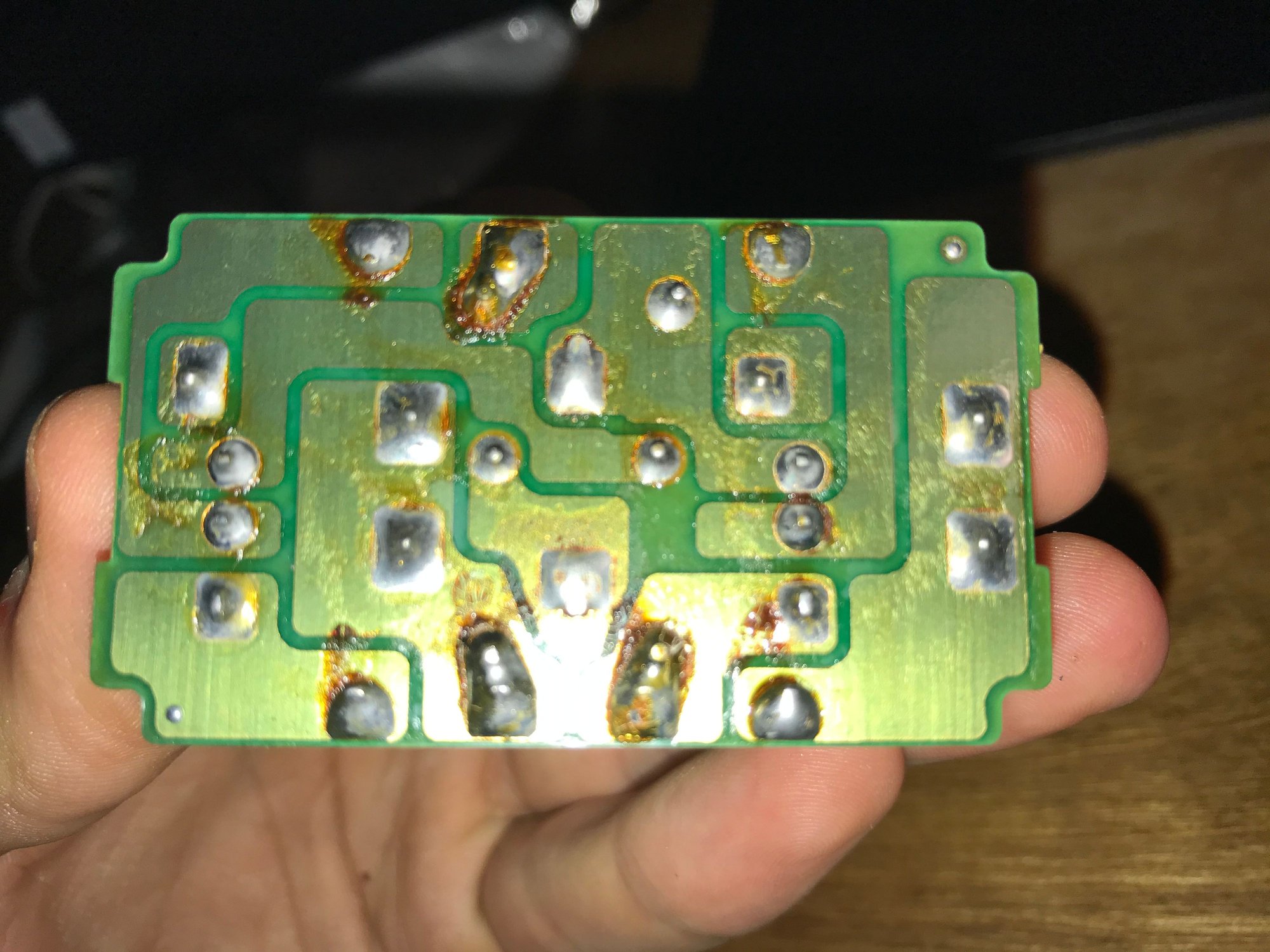

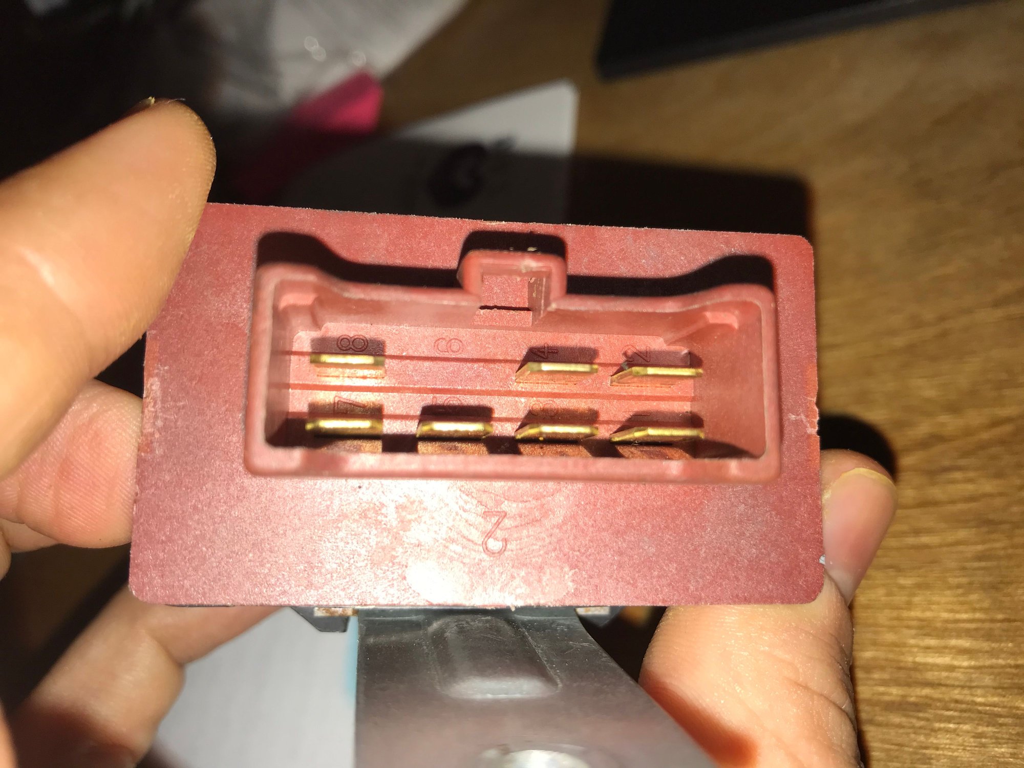

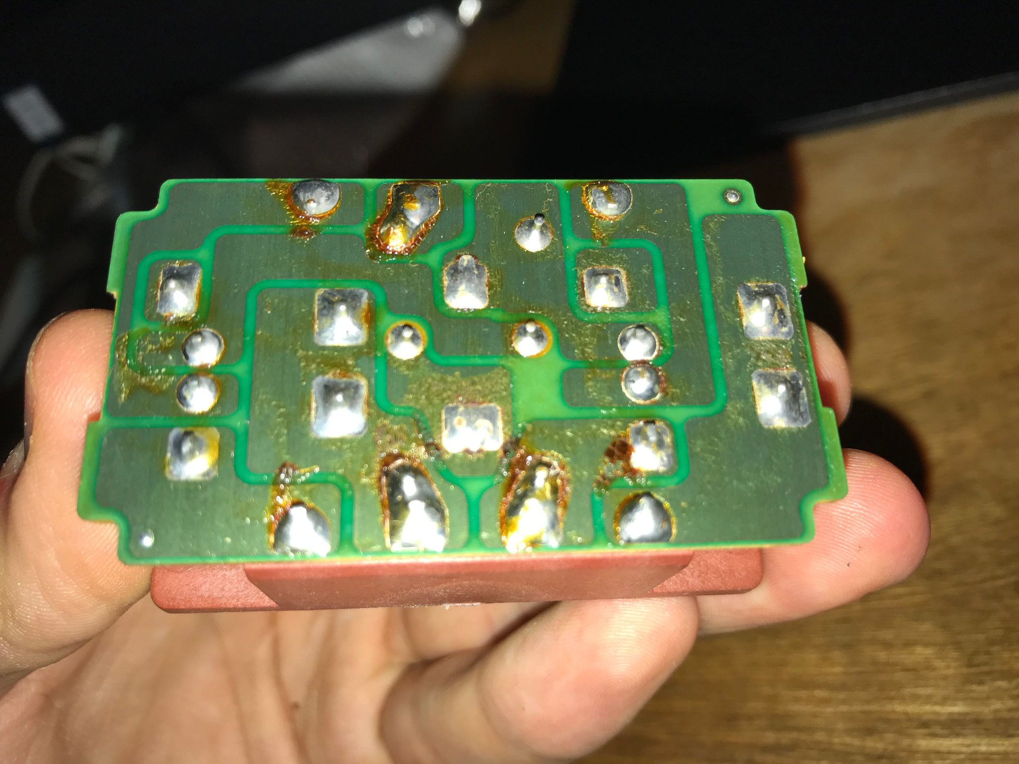

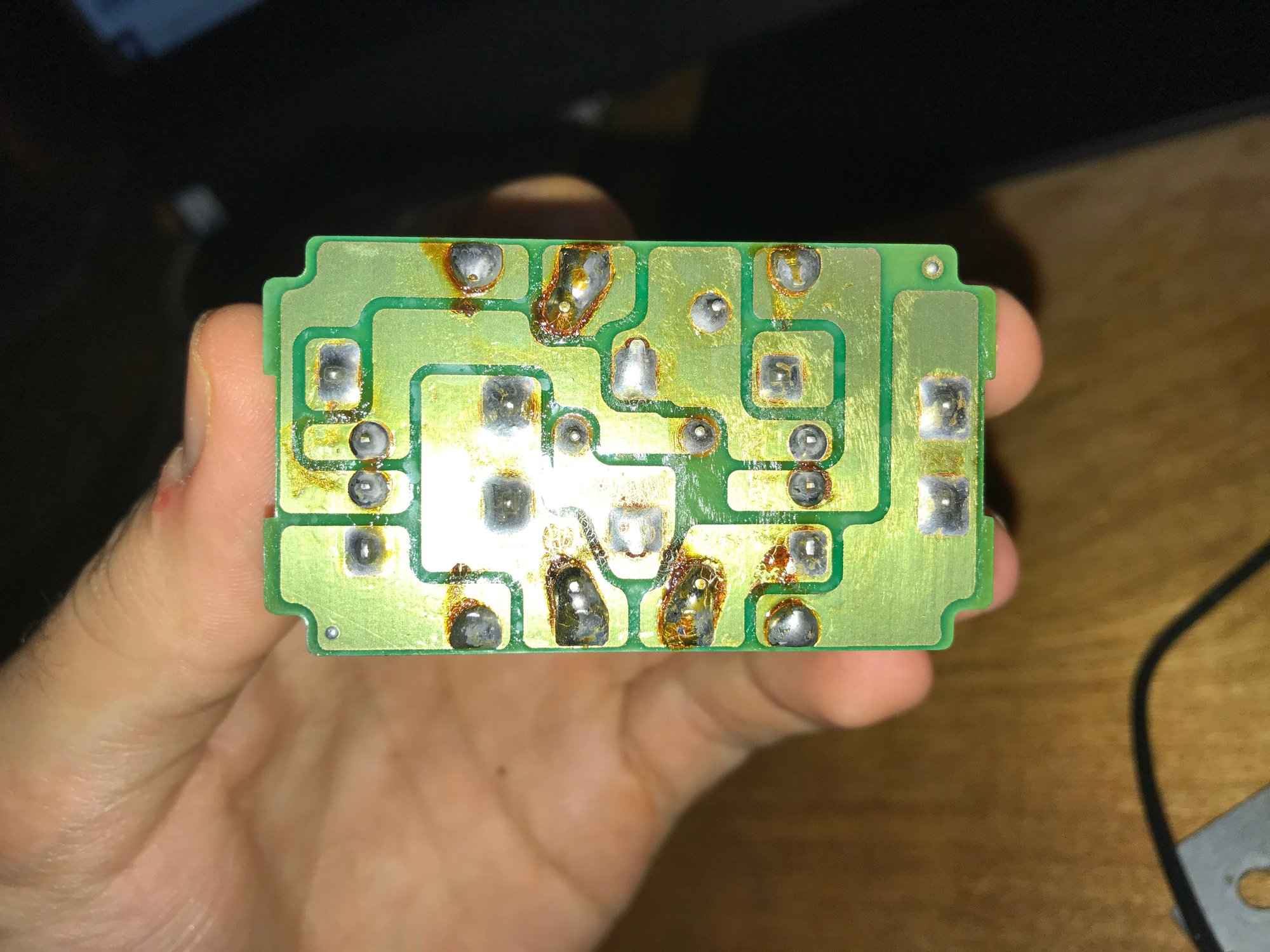

I have a 1991 Honda Civic Dx that will crank but won't start. Even after hooking up booster battery to it and getting well over 13 volts, spraying starting fluid, and checking fuses which turn out to be good, I just simply hear it crank but no fire. However, when I placed my hand on main relay when attempting to start it, I felt no clicking. As I understand, you're supposed to feel a click when turning key over and starting it. So I simply took it out to test it according to these instructions:
https://honda-tech.com/forums/honda-...-pics-2535047/
In the first test, I heard clicking as soon as I hooked mini booster cables to terminals 4 and 8 of the main relay, and I got a resistance reading of 0 when using a multimeter to test terminals 5 and 7.
In the second test, I didn't hear any clicking after hooking up booster cables to terminals 5 and 2, and I got a resistance reading of 1 when I tested terminals 1 and 3.
In the third test, I heard clicking as soon as I hooked booster cables to terminals 3 and 8, and I got a resistnace reading of 0 when I tested terminals 5 and 7.
According to many youtube videos and other internet posts, main relays could be desoldered and then resoldered to make them work again. According to pictures below (if you need better pictures, let me know), could my main relay be fixed by getting desoldered and then soldered again? If so, which points should be soldered and then resoldered?
All answers, tip, advice, and help would be much appreciated.
Main relay terminals
Main relay circuit board #1
Main relay circuit board #2
Main relay circuit board #3
Main relay circuit board #4
