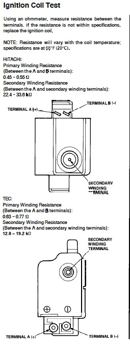

Failed igniter units and ICMs are not uncommon and are often associated with an engine stall.
Make sure to test installed dash fuse 9 with a test light or multimeter. Both top test tabs should have battery voltage to body ground with the key in ON(II). Alternatively, you can check for voltage at the Blk/Yel wire attached to the coil and ICM.
How did you test the coil? Did you resistance test it? Note that you need to subtract the internal resistance of the multimeter (touch both probes together) from the primary winding resistance reading to get an accurate measurement.
