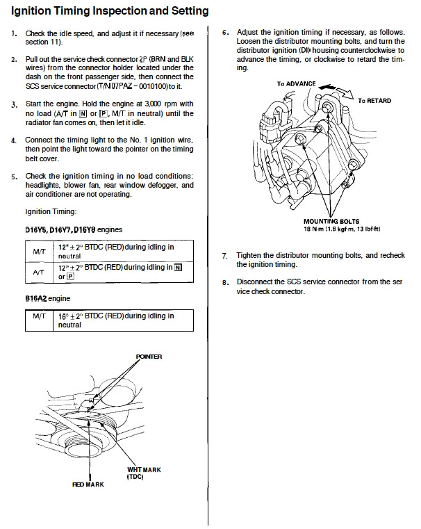

When were the plugs, wires, cap, and rotor last replaced? If necessary, replace them and then adjust the ignition timing with a timing gun:

My advice would be to start by replacing the plugs, wires, cap, and rotor and by adjusting/checking the ignition timing. In most cases, doing such a basic tune up will solve the type of problem you describe. If not, post the outcome, and we'll go from there.
By the way, the coil and ICM in the distributor have lifetimes of approximately 150K miles. Therefore, you might consider having them tested if the basic tune up does not do the trick.
