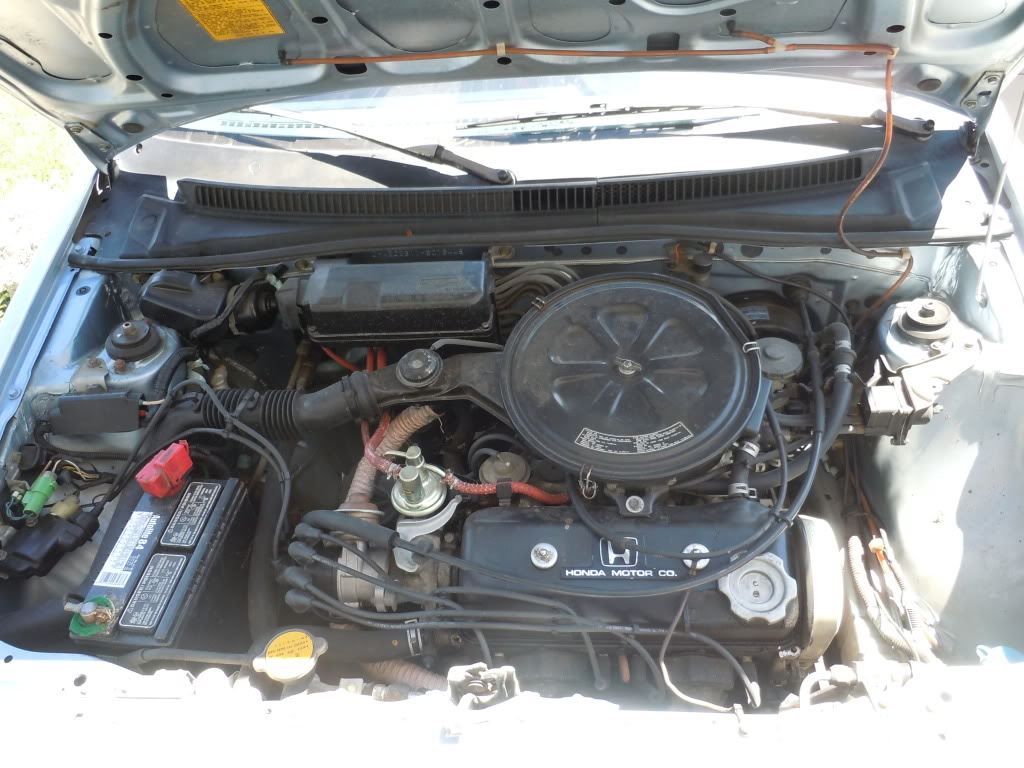

cant think of a good way to explain it, post a pic of the engine

georgevega's Avatar
Joined: Apr 2011
Posts: 20

Yep, that's a carbureted CVCC model. The black box on the firewall with all the vacuum hoses leading to it is some of the complicated stuff.
Post the complete test results. Was the HC high at idle or at road speed? Were the other pollutants close to the legal limit too?
