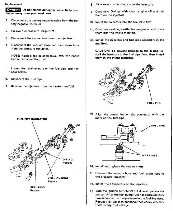

Did you coat the new O-rings and seal rings with engine oil prior to installation?
