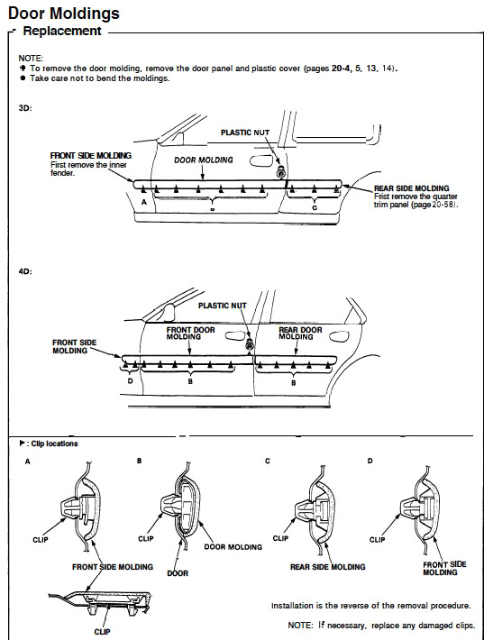

on the outside trim down the sides suposed to be black lol im shure u can replace them but i was wondering if u could get them off with out breaking it and then put it back on ????

I believe they use adhesive tape for that year range. So yes you could get them off, but be extremely careful and you would have to clean off the old tape and get new tape before you could put them back on. but you may want to wait and hear from someone who has an eg before you do it cuz i'm not 100% on that

They have clips, they're on the inside of the doors and fenders. You have to squeeze the clips from the inside of the doors and fenders. I'm pretty sure this is right.

I know that this is how they are on the ek and up, but it seems like I remember seeing some eg's that had the side panels removed and it did not have the holes for the snaps. but I've never worked on any eg's so I'm not really sure at all.
Yep:

Ok so now its definitely going to bug me, anybody know which years have the adhesive? cuz i know I have seen civic without the side panels and it had no holes. I'm not talking about people shaving them, just removing the panels.

I've seen that too, and I believe it was an EG hatch I saw. However, I think they just filled the holes.

i bought mine without the panels
thers no holes and they dont appear to be filled
it may be the trim level mines a cx(i know my sig says dx)
