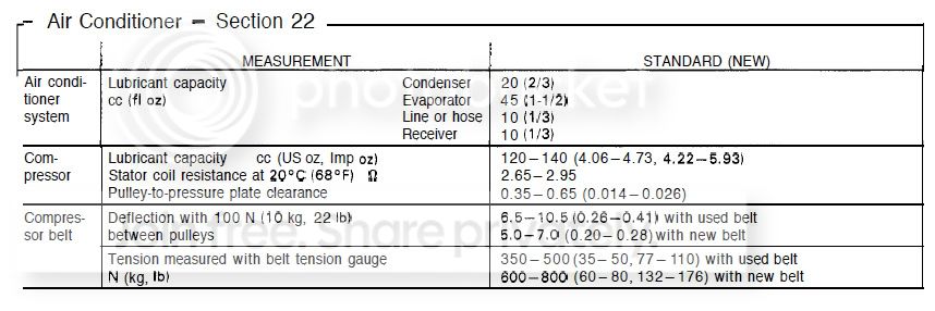

Hi, it's time the get the AC in my 92EXV up and running. Currently it's discharged.
I'd like to make sure the correct amount of oil is in the system after I flush it clean and dry.
How much oil should be in the AC system? I'm not sure the manual has this info. 120cc maybe?
Can I dump the total amount into the compressor?

aha
Now I see, the standards and service limits section, hey there's all sorts of info there!
THANKS!
So it's 205 - 225 cc AC compressor oil, cool, well cool soon perhaps.

It's 4 oz for the whole system. The oil amounts for each part are relevant only when replacing just that part.
You may want to replace condenser as it is very hard to get flushing solvent out of a parallel flow condenser. Also the design of the car leads to a lot of damage to the bottom part of the condenser from road debris. Even if it doesn't leak, when the fins are all munched up you lose performance.
Don't use HC. These cars convert well to R-134a, as the same parallel flow condenser used for the 94 and 95 was installed in the 92's and 93's running R-12. In other words you have exactly the same hardware that the factory R-134a ones do. The main issue is removing all the old oil which you've already done. It is also not hard to get R-12.
As far as initial oil distribution, put a bunch of it in the new receiver, the rest into the inlet of the compressor. Spin the compressor by hand after lines are attached to clear excess oil. Then it is important to have most of the refrigerant charge in before starting the system the first time so you get good refrigerant / oil flow back to the compressor. Charge as much as you can as liquid into the high side with the engine off.
