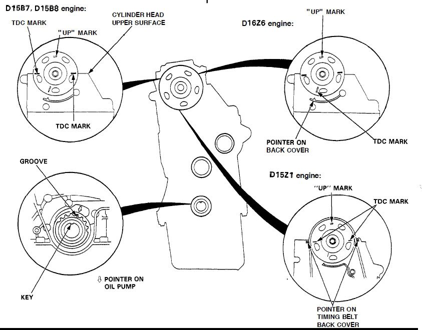

Okay, just use the"new" timing belt you already have installed. You are good to go with the other parts.
Basically, with the cam and crank in the positions shown in the photos, you would remove the belt, turn the crank gear to TDC1 (For details, go to manual link and download the 92-95 Civic service manual), reinstall the belt, and properly tension it (again see service manual for details). If something in the manual isn't clear for you, just post your questions.

The picture shows you how to position the crank gear at TDC1. By the way, how did you remove the upper timing belt cover without first removing the valve cover?
