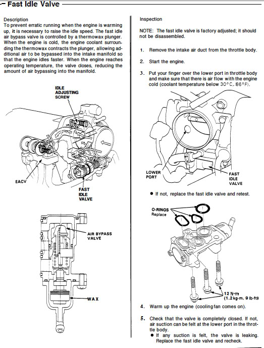

Default RE: 93 Civic revs too long
Sorry for the overuse of acronyms.
Try cleaning the Electronic Air Control Valve (EACV/IACV) and the Fast Idle Valve. Both sensors are located on the throttle body:
I'm not necessarily convinced that this is a problem. If the car hasn't been used in a while and it revs at a high rpm for a couple minutes, that's not unusual. It certainly does this in my car when it's cold outside and it needs to warm up.
Mundy, you could be right, depending on how high the rpms are when the engine is warming.
How high is the rpm at?
If very high, like Ron said, you need to clean your throttle body, could be buildup of carbon in there
