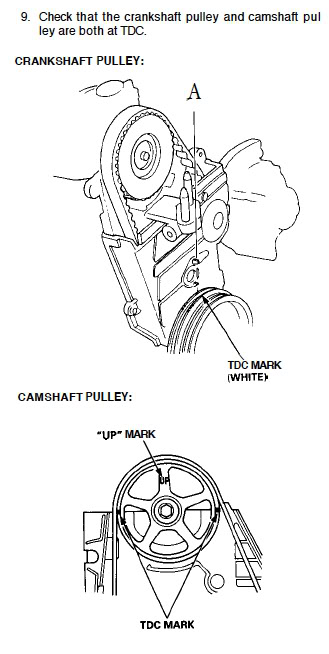

Have you checked the mechanical timing?

No on the timing. Is that something that would just go out while the car is running?

Spark that is not bright white will not ignite the fuel.
Correct mechanical timing:
