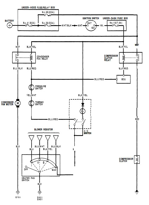

The A/C circuit diagram for 5th generation Civics indicates that the A/C button should light even if the pressure and thermo switches are open, assuming that fuse 13 and the A/C button light bulb are good:

So it's a '95. As the diagram shows, the light doesn't really depend on anything else other than power from fuse 13 and grounding thru the fan switch. See if you have power on the black/yellow (from fuse 13) and white (from underhood fuse box) wires at the relays.
My '95 had a 3 wire thermo sensor instead of a 2-wire switch but the concept is the same. The A/C button starts by grounding the circuit, then if the temperature and pressure are OK the fan relay pulls in and also the ground goes to the ECU which idles up the engine and after a short delay, engages the compressor.
Edit: Also DO NOT get tempted to hotwire the compressor on, if you do this without the condenser fan running, the high side pressure will go up within seconds to a dangerous level and the hose or relief valve will blow out.

Check whether fuse 13 and the A/C switch is getting battery power when the ignition switch is turned to ON. If you have power at both locations, then the problem could be:
1) A bad A/C switch on the dash.
2) A burned out A/C switch bulb (+ separate A/C problem)
3) A broken wire between the A/C switch and fan switch
4) A broken/disconnected ground wire from the fan switch (in this case, fan also wouldn't work).

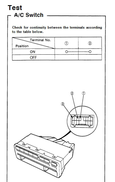

Here's how to test the switch:
