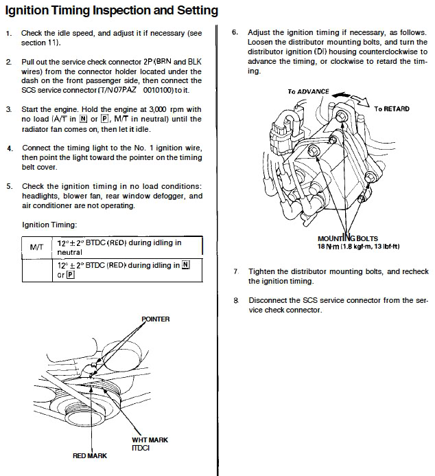

Has the timing belt been replaced within the ~100K recommended interval?
First fix the CEL code indicating an IAT sensor problem. If the issue persists afterward, then check the ignition timing:
