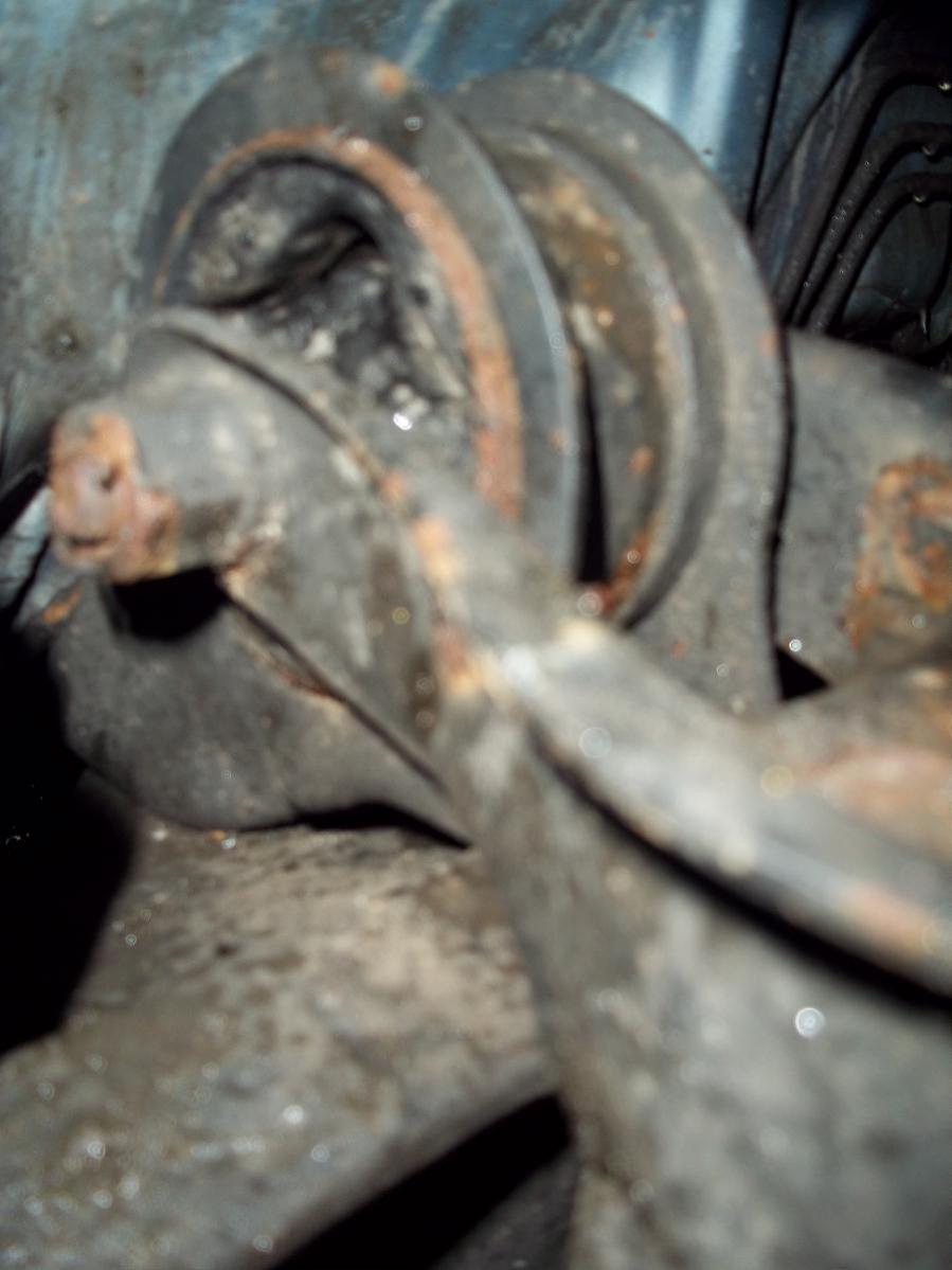

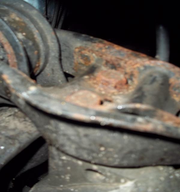

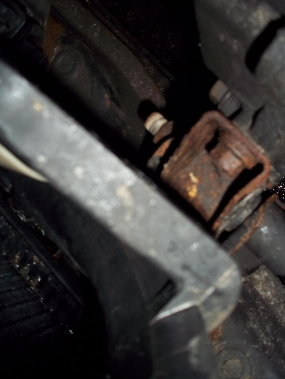

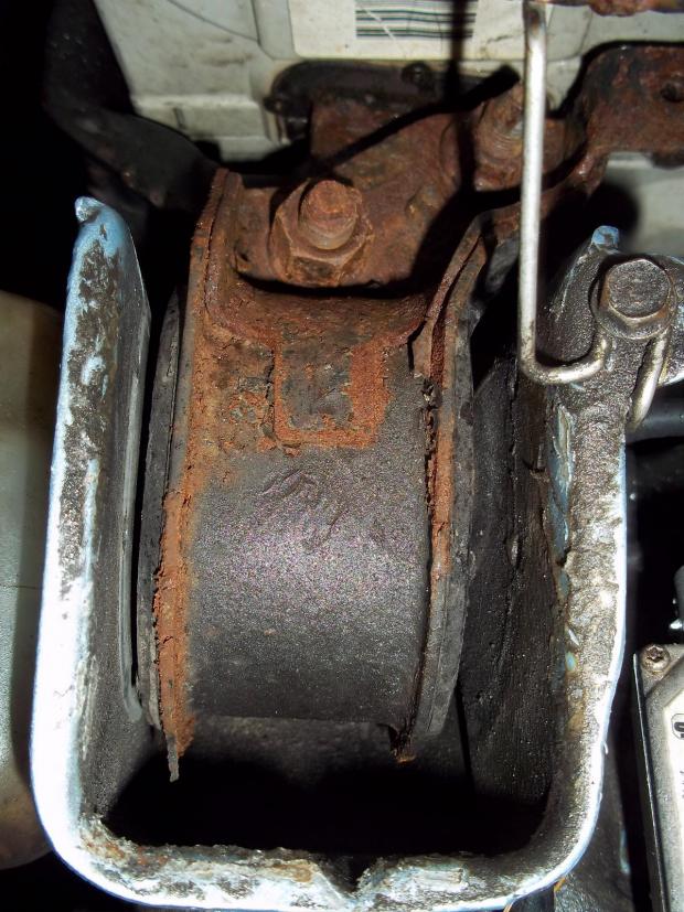

The motor mounts look rusted and old. I have attached some pictures of them. They are kind of bad pictures but I hope it helps.

is it just me or do the last couple mounts not look so good?

It's very hard to tell with those blurry pictures but the 3rd pictures the rubber in the mount doesn't look all that good. The brackets for the engine mounts generally don't break for these cars, but the rubber inside them cracks and tears. This can cause the shaking you're feeling.
