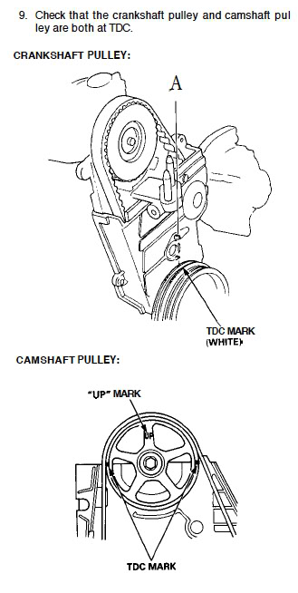

Spark should be bright white. Weak yellow or orange spark may indicate a bad coil.
Does CEL work? Mechanical timing:

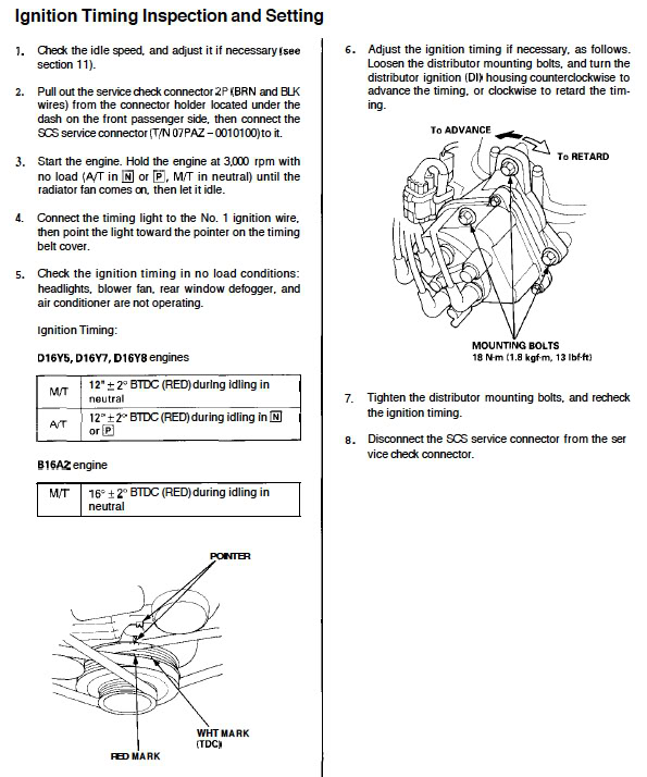

  #30
Originally Posted by Got-a-D
how do i know if is working properly. (cel)
When you turn the key to ON(II), the CEL should turn on and then off after 2 seconds, if no codes are thrown.
havent checked timing dont have a gun but will get one when store opens tomorrow.
