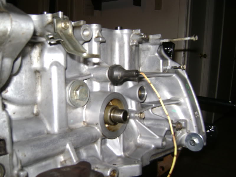

Have a question maybe you can give me the answer.Where is the Oil Pressure sensor on a Honda Civic 98.

It's on the back of the engine block under the intake manifold.
Old Oct 14, 2010 | 06:56 AM
mk378's Avatar
Posts: 10,023
Realize that that sensor is connected only to the red oilcan icon light on the dash. It has nothing to do with the yellow check engine light.
