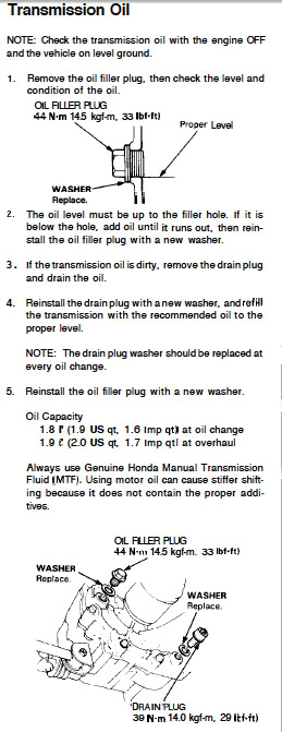

you put a clutch kit in or just a clutch?? Ya also like Ron said you check your tranny fluid?
Just a new clutch.
How can I check that fluid?

http://hondatech.info/downloads/Auto/Manuals/Civic/
RE: clutch question
RonJ is correct. I have never had a transmission fluid change done along with an oil change. First of all, they are not even in the same area. Second, the transmission fluid only needs to be changed at certain intervals while the engine oil needs to be changed every 3000 or 5000 miles.
I had my transmission fluid changed recently (1 yr ago)and it has been a lot smoother especially in colder weather.
