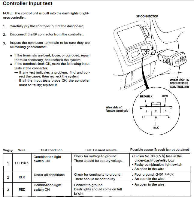

Old Oct 24, 2008 | 08:18 PM
You obviously have an electrical short. I think the dash lights brightness controller is a prime suspect.

i got the controller out and disconnected it and none of the wires or prongs look bad... how can i test this further?
