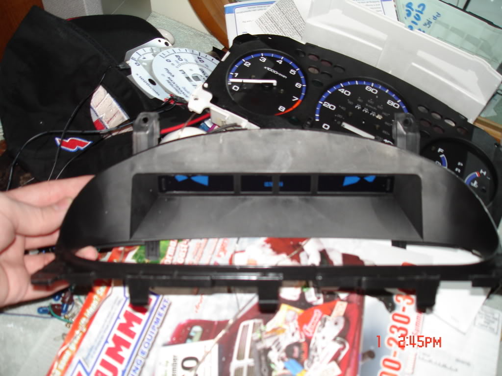

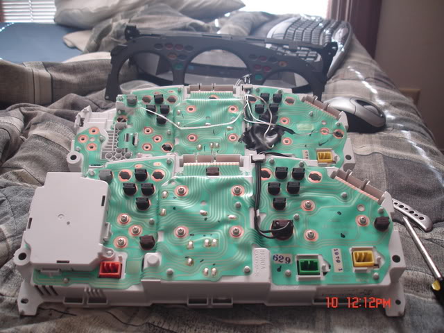

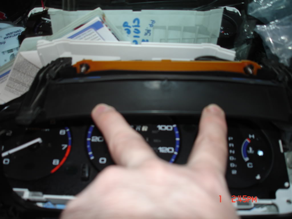

so some of your dash/cluster lights work? if some work then its either loose plug or bad bulb.
if its on the cluster. pull the cluster out, 2 screws ontop holding the black bezel on it and theres 2 TIGHT clips that hold the bottom part in. so it will take alot of force to pop them out. then its simply 4screws holding the cluster in and you can angle and pull it out.
check this bulb with the 2 black wires on it, it could be that the bulb socket simply isnt tightly turned/locked inplace...
see it also lites up the outter 2 bulbs on this piece as well.... that 2nd socket/bulb could also be loose keeping the other 2nd bulb on the other side not to work...
then just plug the cluster back in and see if bulbs lite up
