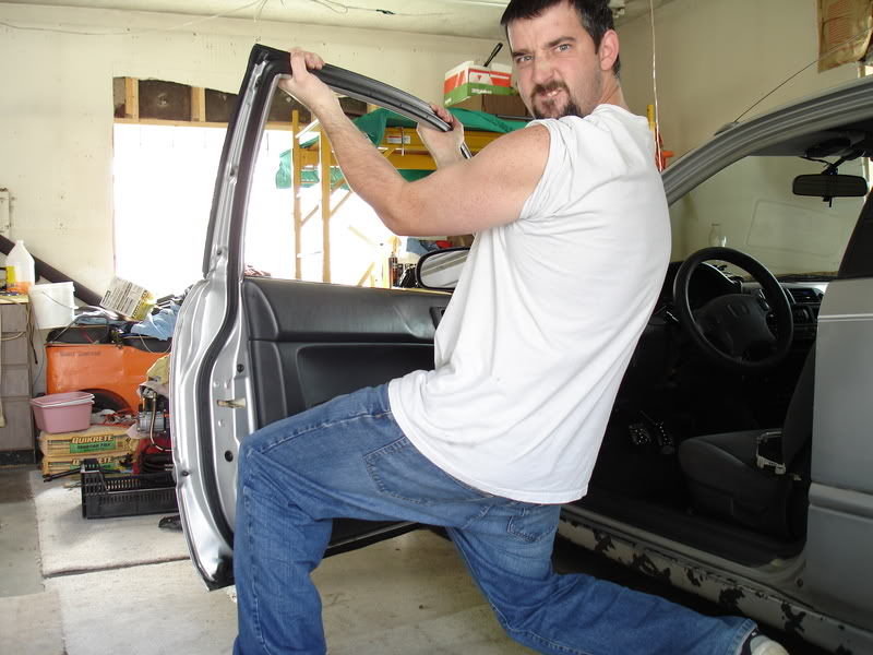

so the top window post frame on the door is out to far.... SIMPLE FIX, roll the window down, brace the door AND PULL.
the top frame over time bends out alittle from every time you close the door. it happens to every vehicle with a top window frame!
dont worry about bending it to far. that frame is pretty strong and if you bend it to far/tight then closing the door afew times should push it back to normal.
LOL everyone is skeptikal. but it really works. people thing there hinges are bad when its not since the rest of the door lines up perfectly.
my dad taught me that with my old truck that had wind noise. i was just like you where... im like WTF are you doing pops.... but gave it a drive and the wind noise was gone.LOL
