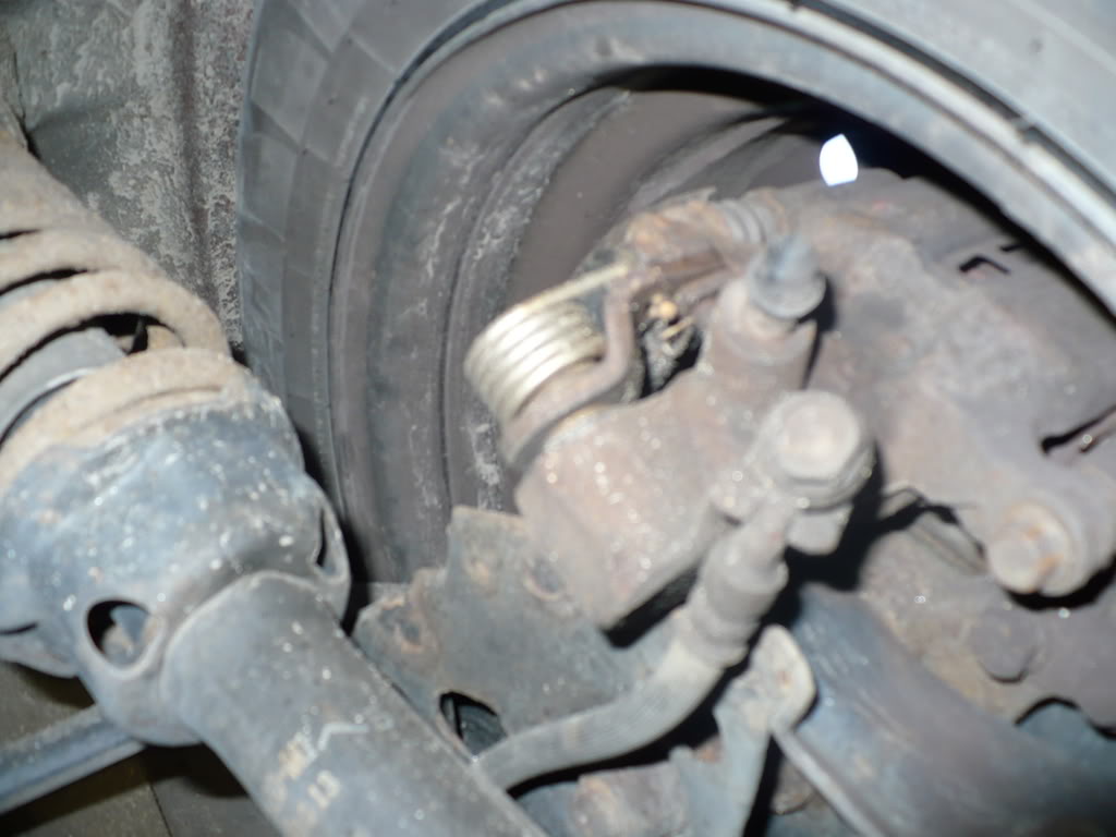

don't forget to clean and re grease your e-brake "flange" it is the one that is to the left of the rotor. You should reconize it. If you don't then they will begin to stick and your brakes will rub like crazy. making this god afaul smell. ill post a picture. I had this problem where i could pull my ebrake all the way up and nothing would happen so i took my rear wheels off and checked everything and it turned out to be that "flange". I will take a picture and put it up here. If you have some teflon lubrication spray just spray it all over both of them
Old Oct 25, 2007 | 12:49 PM
95civic1.6l's Avatar
Posts: 811
From: Western Mass
Default RE: first time civic owner needs help
those are the "flanges i was talking about But they are actually springs. Spray them down with brake cleaner. they may be stuck in the closed position meaning they will be pushed towards the rear bumper. If so take a flat head and a hammer and hit it till it pushes back. Not to hard though. Then when you loosen them up you should spray them with a lubrication spray like the one i showed in the picture. This should be done so they don't ruin the rotors and brake pads. This will save you money if you have all this already
