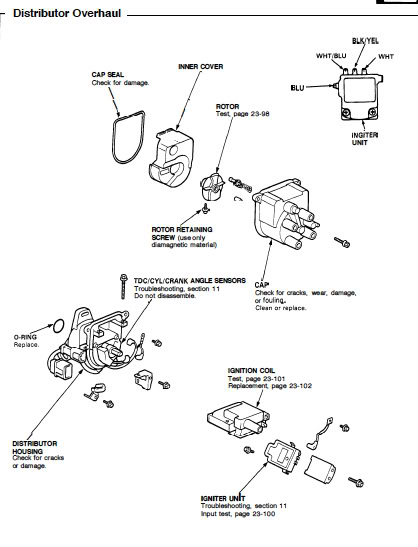

Can you see any burned or damaged wires in the distributor?
Is there any moisture or corrosion in the distributor?
How old are the plug wires?
Is your distributor missing the inner cover?

all of my connections are clean there is no moisture i just replaced the wires so there about a month old now and i have the inner cover
