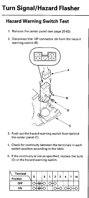

What happens if you remove under-hood fuse 5 or under-dash fuse 19?
I don't think it's the hazard light because when i disconnect it there isn't any difference
What exactly did you do here?
I agree with andry, check the hazard switch:
