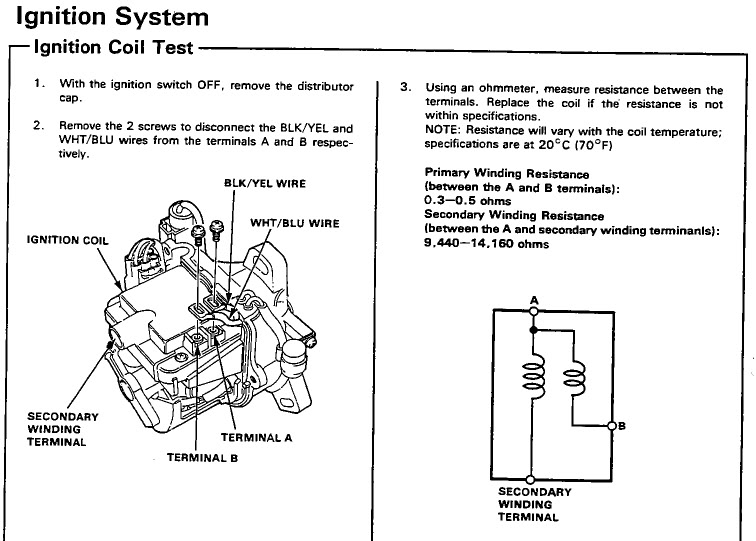

I suggest that you inspect the timing belt -- it may have slipped a tooth. You might also consider compression testing the cylinders.
Based on the weak spark, the igniter or coil in the distributer might be bad. Here's how to test the coil:

ok so here is what it was. evidently the kid hit a bump and knocked the catalytic converter guts loose cloging the pipe. thus no run but a bit. it must have backfired and screwed up distributor. after a new distributor 125.00 and a cleaned pipe and new muffler all is well. a hard one to diognose.
