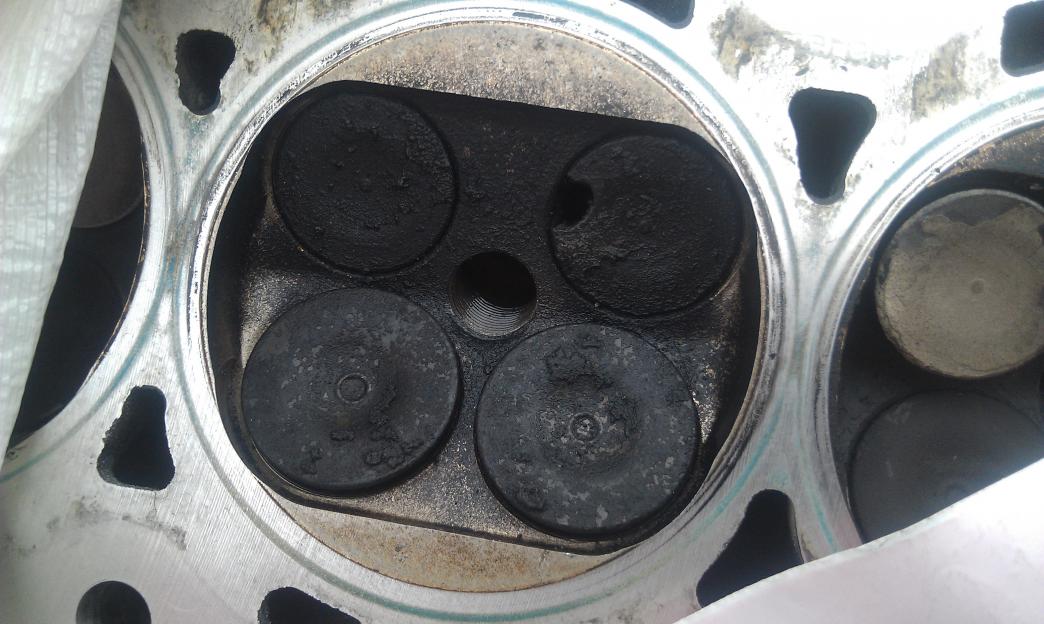

help burning the same exhaust valve on 3rd cyclinder-img00163-20120331-1408.jpg
first time it burned

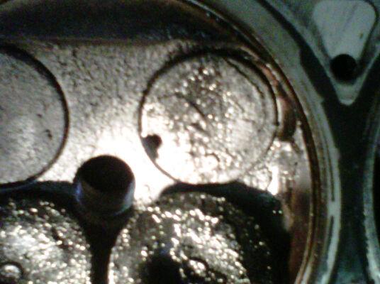

second time it burned
Now the car has died the third time now but don't have the pics but its the same valve. Also had new injector installed this time.
Every time I get the head redone it still burns about 1 qaurt of oil every 300 miles. The car used to get about 36 till the first exhaust fail but now it only gets about 30. There are no mods done its all factory.
So any ideas? I am thinking on just ordering a rebuilt head form like oreallys or auto zone.

You have an issues with that cylinder. Why all the oil residue on those valves.
