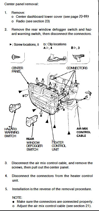

You need to remove the center panel. Trustdestruction recently created an excellent thread with links describing center panel removal for many types of Hondas, but the links seem now to be dead.
These diagrams should help:

Old Nov 9, 2008 | 11:54 AM
ya i screwed up with that DIY... the cluster has 2 more screws.... i didnt know because mine where already missing... you have to pull out those top 2 switches on the console to get to 2 screws behind them... use a small flat screw driver to pop them out and just unplug them and remove the screws then the audio console will come out.
my bulbs both didnt work. but luckly i had abunch of extra bulbs from cuting apart a few clusters over the years so i just shoved in some fater bulbs into the sockets and it worked great.

follow RonJ's diagrams. you might also benefit from download the fsm for the 96-00 6th gens. i have found that very helpful. follow the link in my signature and you'll see it. I did this repair myself about 1 year ago and it was pretty easy since I had installed a CD player which required me to remove the factory stereo to connect the CD player connector to it. Then I put everything back. Once you remove the climate control, the bulbs (2 of them) are right in the back of it. very easy once you get the climate control out. remember also to be careful with the heater blend door lever. you want to adjust it until it closes tightly for cold air.
