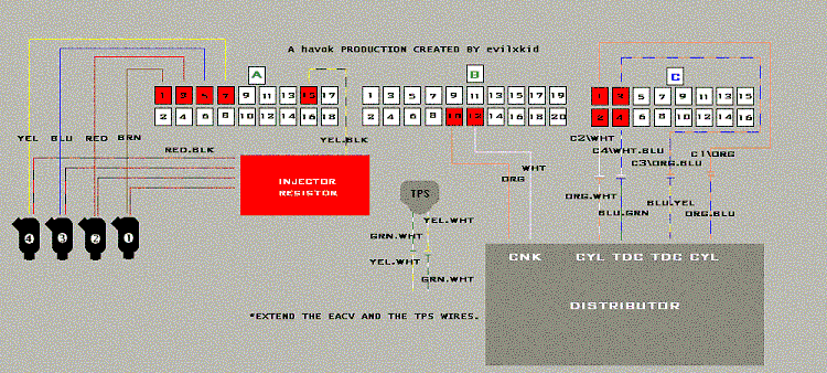

Old Sep 8, 2009 | 06:50 PM
if you use the d16a6 with its manifold then you will need to do a dpfi to mpfi.
your harness only has 2 fuel injectors. the d16a6 has 4. you will also need a 88-91 si ecu pm6

thanks for info but now what motor needs no wiring or any mods that will do better than the pos d15b1?
Old Sep 8, 2009 | 07:00 PM
nothing with out the mpfi conversion. its not really the motors fault its the intake manifold thats where the pos comes in. if/when you do the conversion you will see a big difference.
