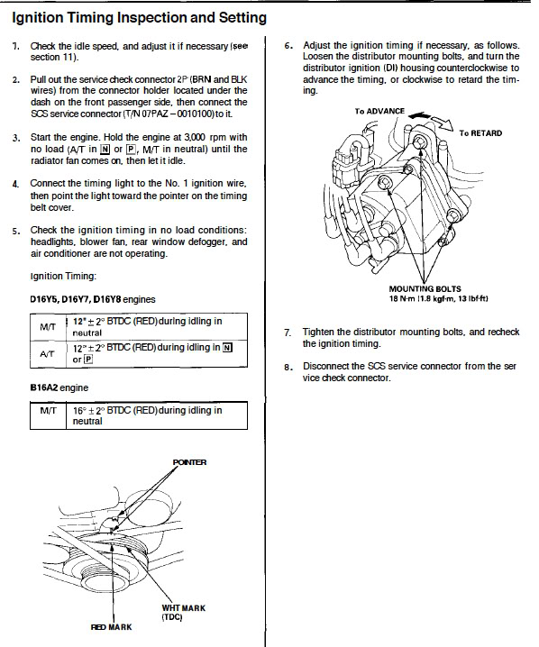

Have you checked whether the ignition timing is set to spec?

no i didn't. my dad thinks it don;t advance like its suposed to and that its a knock sensor thats bad. what does that sensor do? i have ngr raceing plugs and new wires. i am throwing an engine light, iat sensor and the vss. how would the ignition time be off if it runs perfect? how can you check it? what is my dad refering to when he said advance mechizm not advanceing?

does anyone know how to hook up a timing light to check the ignition timing?
Old Aug 16, 2009 | 10:26 AM
Inductive clip to #1 plug wire (closest to timing belt).
Red clip to + battery post.
Black clip to engine valve cover bolt.
