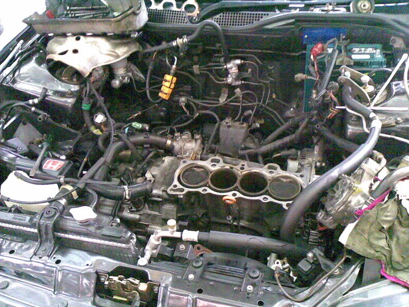

Now the workshop told me that my engine is gone. I wonder if they are telling the truth. This morning, they removed my top engine.
See pictures:

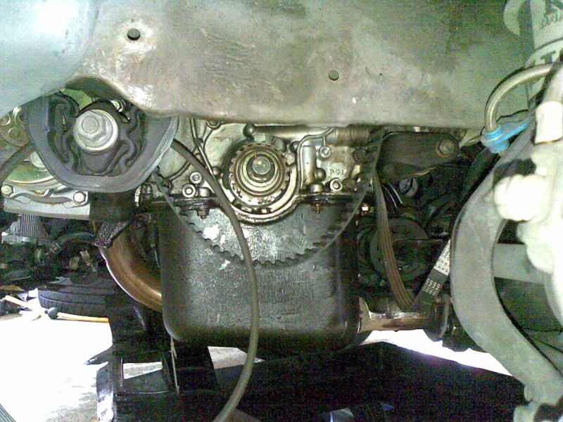

Deep socket is used to crank it, but struck at position. Wont turn anymore even with force.

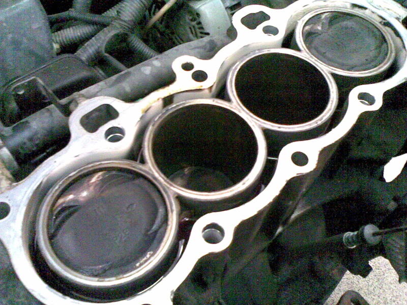

The first and fourth piston is out by 2-3mm in height. Second and third piston is levelled. IS THIS NORMAL?

I would like to know if my engine is really gone. Is that the reason why my car wont start at times. I would like to know if the shaft can crank freely if normal.

Is this car a manual or automatic? If it's a manual, you won't be able to turn the crankshaft pulley bolt easily if you left the car in gear.
Can you describe in more detail what happens when you try to start the car and can't?

I am driving automatic transmission. I placed my shift in neutural position but unable to crank the shaft completelywith a deep socket. As the 1st & 4th pistoon move up, 2nd & 3rd piston move down. Till they are struck at the position as shown in the photo. I tried to crank with my strength but to no avail.

if you put a socket on the crank bolt & it should spin around & around , with ease, if it gets to a point where you can't turn it , i'd say you may havea bent connecting rod or crankshaft
regardless if the motor wont spin around easy - its toast
taking the head off was a waste of time & $$$ all they had to do is take the spark plugs out & try to crank it by hand to find out it wont turn all the way around

since the fourth and first pistons are not at the same height, that would mtell me something is wrong, possibly a bent connecting rod or bent crank? either way they should be the same height under all standard circumstances. i dont know how it could get like that, when you do something like that its usually gonna be a pretty loud noise and a change in exhaust note if it keeps running, not somthing that you can ignore unfortunatly.

I dropped the oil pan and removed all the four piston. The no.1 connecting rod is slightly bent. No other faults are found. This may be the reason why my car won't able to start. Now, I am curious why the connecting rod is bent????
