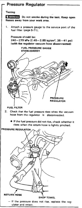

My chilton manual says to pull the vacume line to the fuel pressure regulator, and the psi should be 36. This is great for testing the pump, but no instructions are given for testing the fuel regulator.
It says that the regulator holds fuel pressure at 36 psi above maniforl pressure. but does not give what the psi would be at normal idle, or what it would be at say 3000 rpm.
Knowing what the fuel pressure should be at idle, and at higher rpm, would be a good way to trouble shoot the regulator
Checking the fuel pump is straight forward.
Any thoughts on checking the fuel pressure regulator?

Default RE: O2 sensor going bad?
Old May 3, 2008 | 05:43 AM

Thanks for the picture that showed to pinch the return line.
now I am off to the hardware store to try to cobble together an adaptor. No one had a tester that fit hondas, the kid at the parts store works on hondas and he said that what he had to do was take a bolt the same as the one in the test port and drill a hole through it. You can then use a rubber hose to connect.
This sounds like a lot of fun. any thoughts on making an adaptor?
