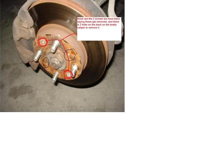

  #37
mk378's Avatar
Posts: 10,023
Look for two small tapped holes in the rotor, they will be between the wheel studs like the two flathead screws but 90 degrees rotated. If you have the tapped holes you can put two M8 bolts in them and tighten alternately to force the rotor off.
Old Sep 30, 2009 | 10:50 PM
  #38
TheJGB3's Avatar
Joined: Mar 2008
Posts: 379
From: Lake Wylie, SC, USA
Originally Posted by usmcyoung
alright boss Im going to bed I have to get up in about 3 hours to go run 3 miles (gay) one more question do they even make a big break kit for the dx?
If you want bigger brakes you can put 96-00 EX or 99-00 Si knuckles on your car.
The EX/Si setup is larger rotors, calipers, and pads.
As for the rotor problem you are having all you have to do is screw in 10MM bolts into the threaded holes in the rotor (the black circles in the pic). Screw each bolt in two turns at a time until the rotor comes off.
