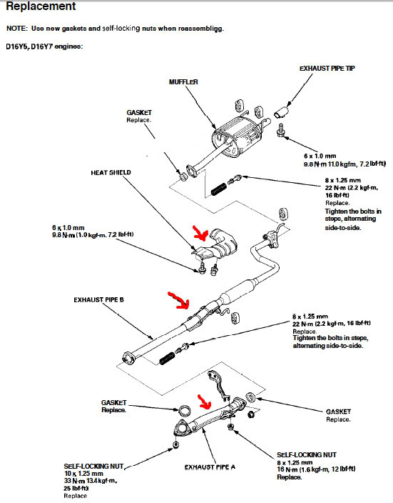

Sounds like a loose or cracked exhaust heat shield. The bad shield can be tightened or repaired (my preference), although some members will recommend that you simply remove the offending shield.
If you have a D16Y7 engine, this diagram will help identify the shields (red arrows):

dito the heat shields are well known for rattling! i dont think they are really needed since most people just remove them.... hell my 96 came without the heatshields on the header already.LOL
Old Nov 2, 2008 | 05:57 PM
Heat shields are the most likely explanation, but mine also rattles when I accelerate. Have you noticed if it comes from one side more than the other? My rattle turned out to be a failing driver's side CV axle.
