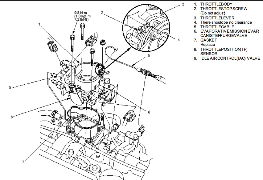

The Throttle Position (TP) sensor is located on the throttle body. If the sensor is bad, the service manual indicates that the entire throttle body must be replaced; however, if you are handy, some members have mentioned that the sensor can be purchased separately and installed.

The throttle body is connected to and draws air from the air cleaner (see below). I don't know how to replace the TP sensor, but hopefully one of our experts can help walk you through the process.
