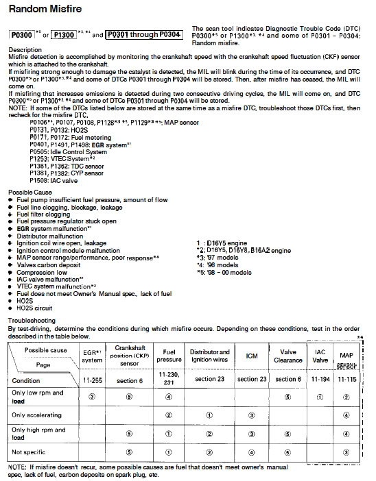

Old Jul 31, 2008 | 05:42 AM

did you even check the plugs that you need to replace after you always seafoam. plus, how long has this been going on for? and did you have any of those symptoms before the seafoam process.
