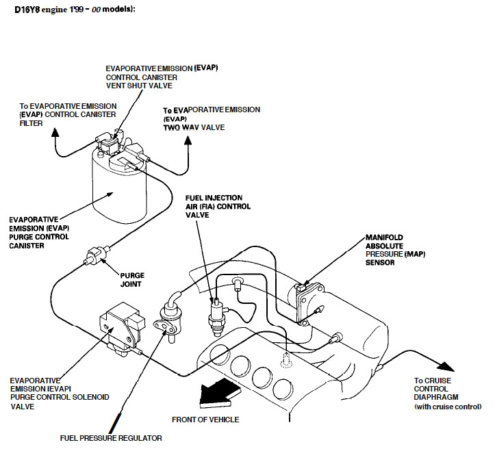

i swaped my motor after throwing a rod i cant rember were it gos d16y8 sohc
Old Aug 11, 2010 | 01:56 PM

thanks its been a great help i love forums
