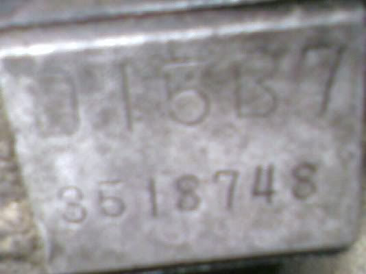

1995 honda civic EX blk coupe
131k miles

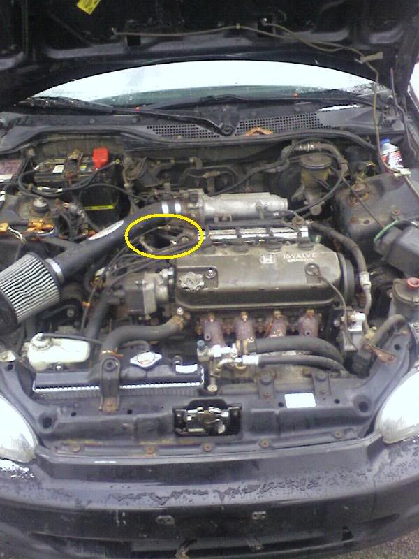

5.DOes there need to be a hose connecting the valve cover to intake?

3.i don't think this car has its original motor?
no it is'nt the original motor if it truely is an EX
Need no as long as the intake hole is plugged and the valve cover has a breather (a mini air filter thing)

glad to be here ok so i got the small air filter covered the hood wire is it hard to change.
and yea the title reads ex im pretty sure it is one.
Yes, it is called the breather hose and it is part of the PCV emissions system. Just hook it up.

ron would a little intake filter work as well or should i go with a hose? does it make a differnce?
Old Jan 26, 2010 | 08:38 AM
A filter will clog and therefore requires maintenance whereas a hose basically doesn't.

ah now we are getting somewhere perfect thanks
