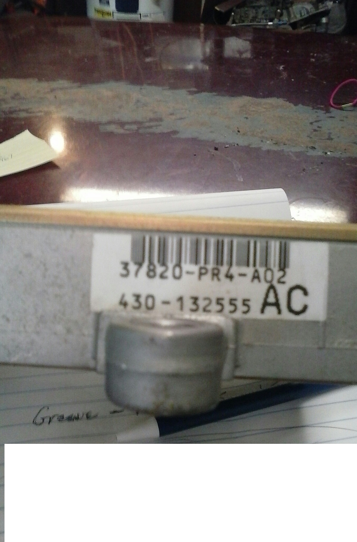

Got a new exhaust on. Cleaned up some odd wiring and random relays. Found a jumper in the main fuse box that bypassed the blown main 60A fuse, replaced fuse and threw away jumper. Still running a bit rich and the idle is a little better. Here is the ECU that is in the car as well.

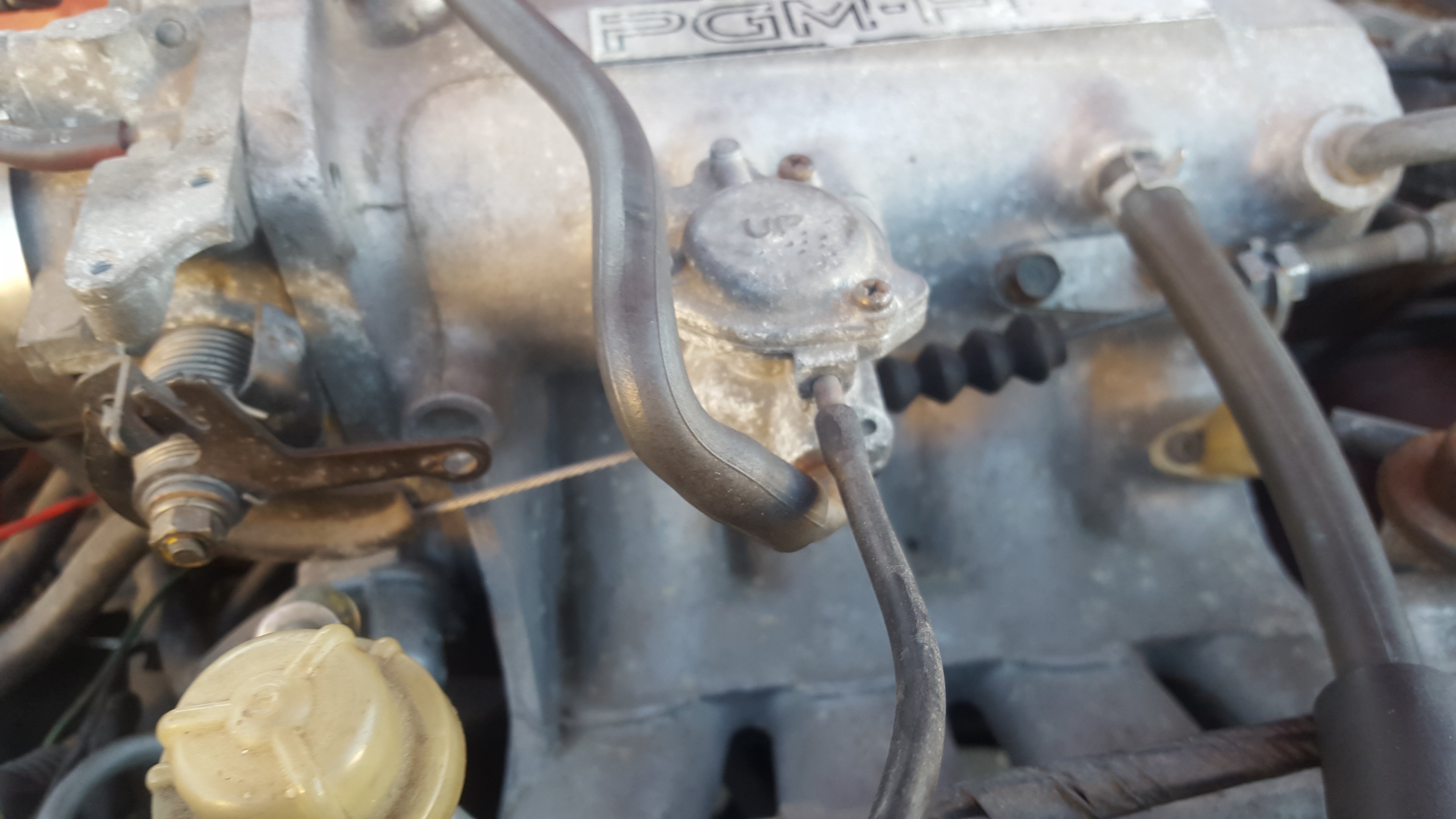

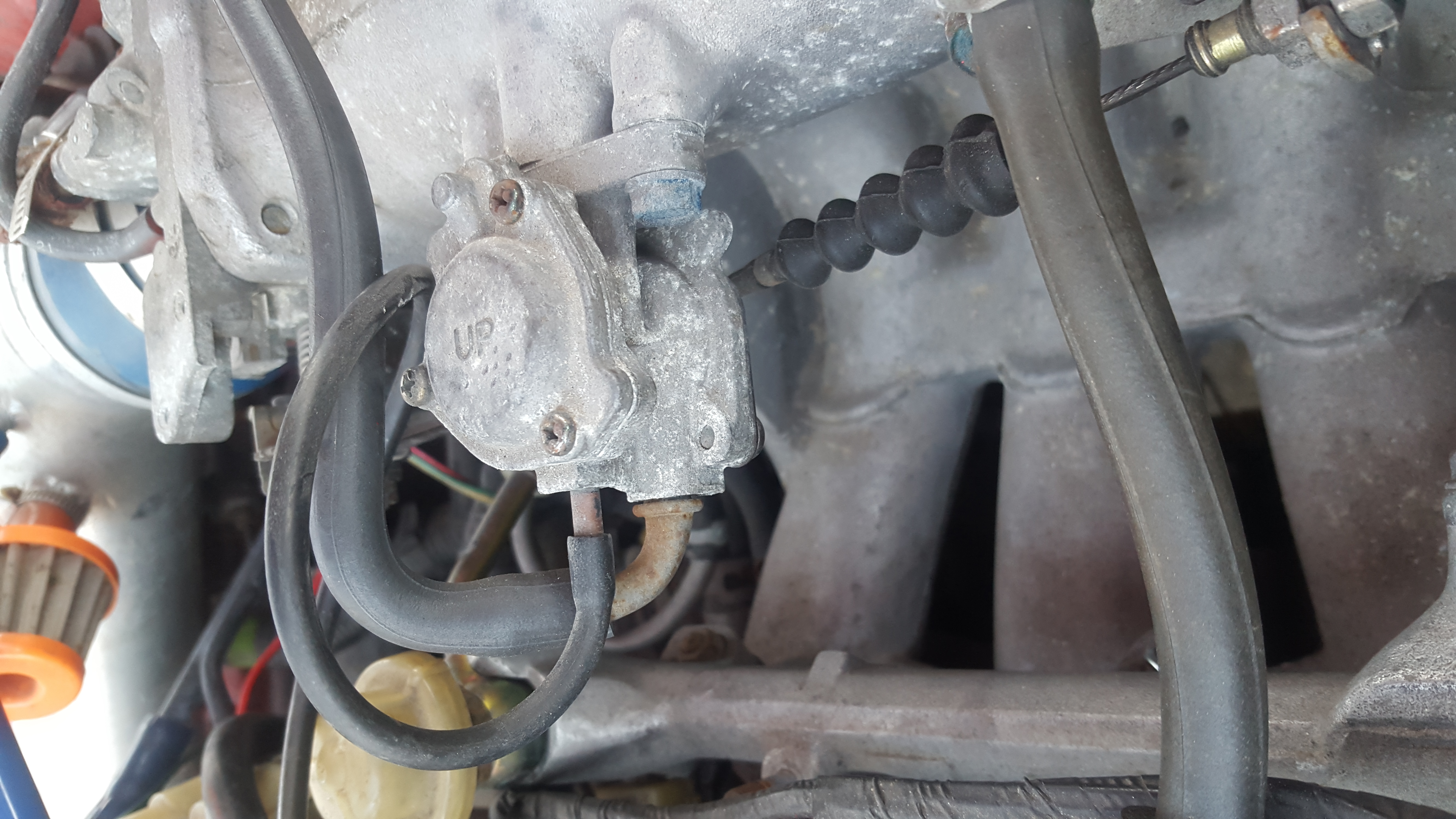

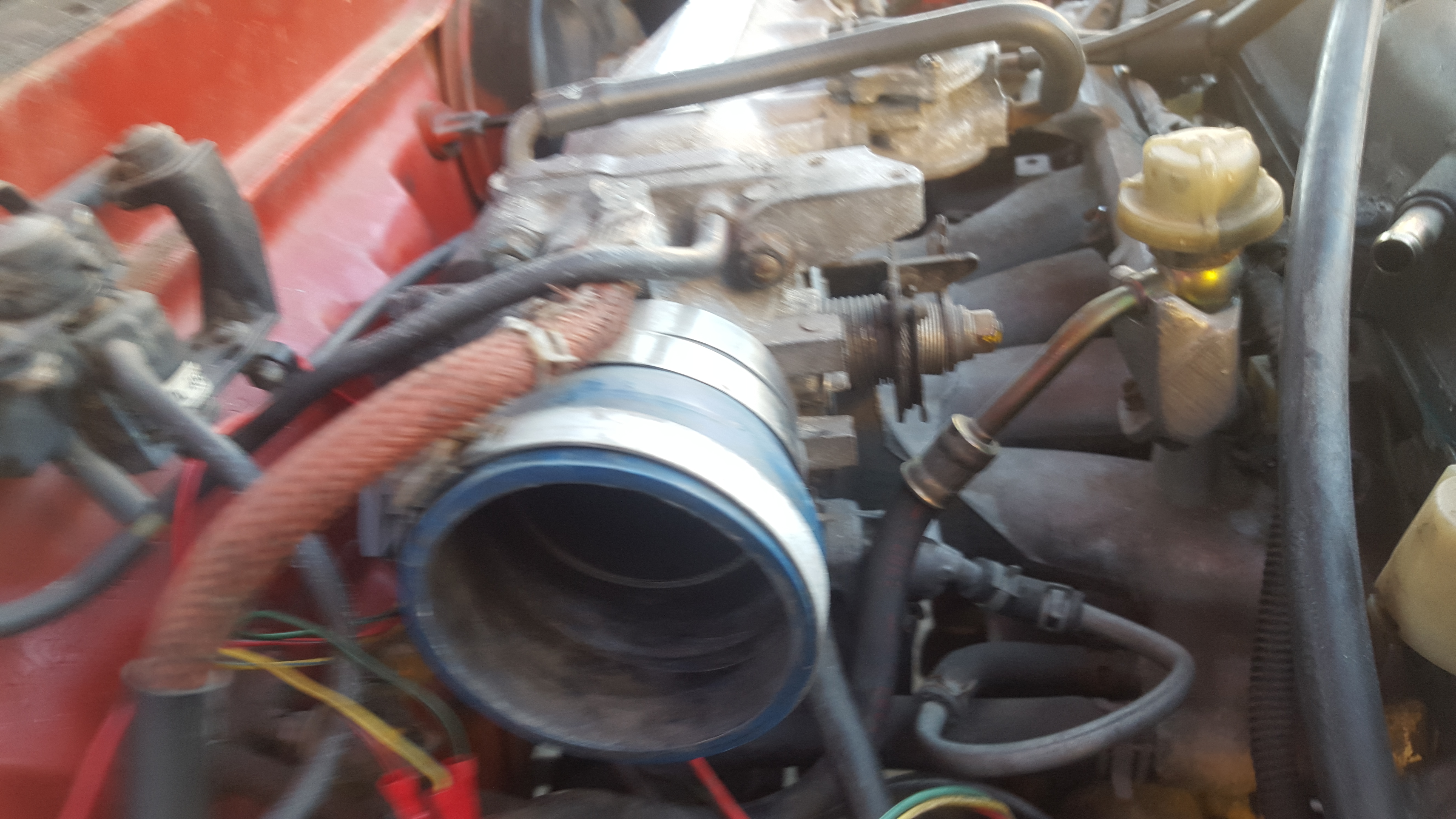

Here are a few more photos of the intake mani. I do have a question what is the small tube on the small cylinder supposed to connect to?
