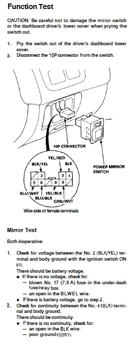

i have an automatic 96 civic ex, and my power mirrors aren't working, i hear no noise at all when i press the button to move the mirrors, is it the motor that may be damaged or is it a fuse? if it is, is it in the hood or under the steering column?

i checked all the fuses and they are all fine
Old Aug 11, 2008 | 03:55 PM
Perform the function tests in the diagram. Post the results for more feedback.

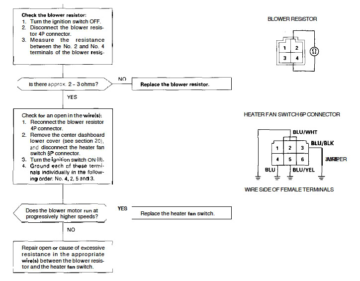

and i got another problem. My a/c will only work on #3 and #4 speeds. Is that fixable?
This is probably a problem with the blower resistor:

okay well for the mirrors i checked every single fuse and they were all fine. but i changed every single fuse anyway just for the hell of it. i cheked all the wires that have to do with the mirror and they are all fine, so im guessing yea its probably the motor, but im not so much worried about the mirrors.
I think it would be rare to have two bad mirror actuators. Now test the mirror switch:
