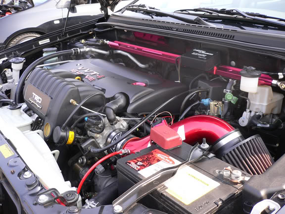

here is my setup... you can see the injector mounted on the intake:

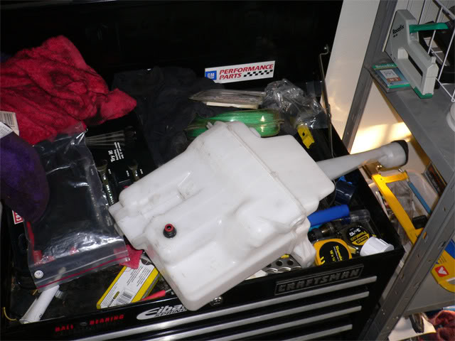

I tapped the windshield washer reservoir and just use that as my water/methanol tank:
