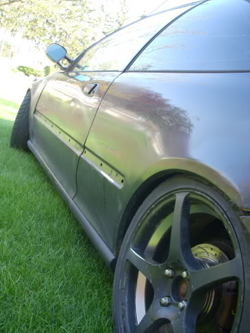

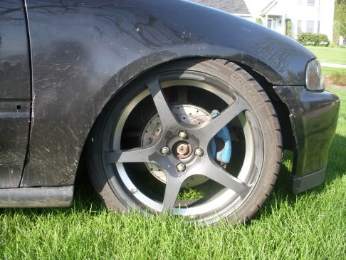

'94 EX, so not a 6th gen, but here was my setup:
Ground Control coilovers
KYB AGX struts
The drop would have been hard to measure given that they're coilovers, but I'd estimate it was between 3" and 3.5" in front and somewhere between 3.5" and 4" in back. The ride wasn't the greatest (it softened up a lot once I went back to the steelies), but it wasn't bouncy, either. Granted, my suspension needed to be pretty stiff to support the drop I had, but still.
Pics:
KYB AGX struts
Pics:

CivicChick, if you were asking about the tires on my old civic, they were 205/40-17s (3.22" sidewall) with about 0.5" tucked up front and about 1.5" tucked in back.
