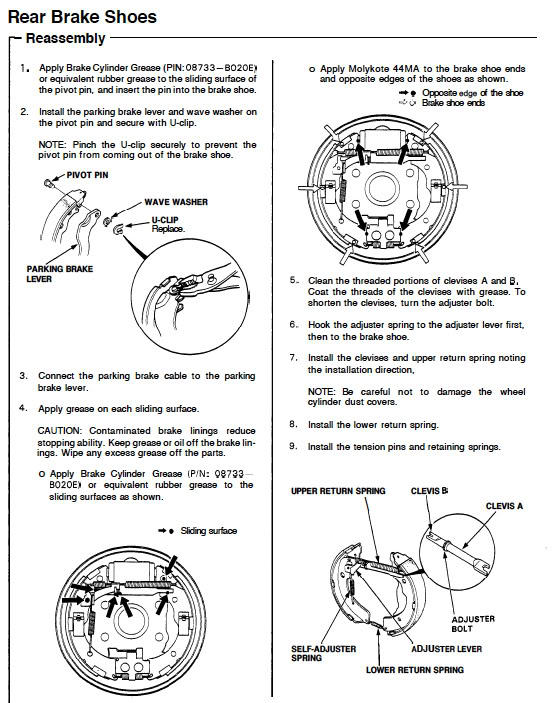

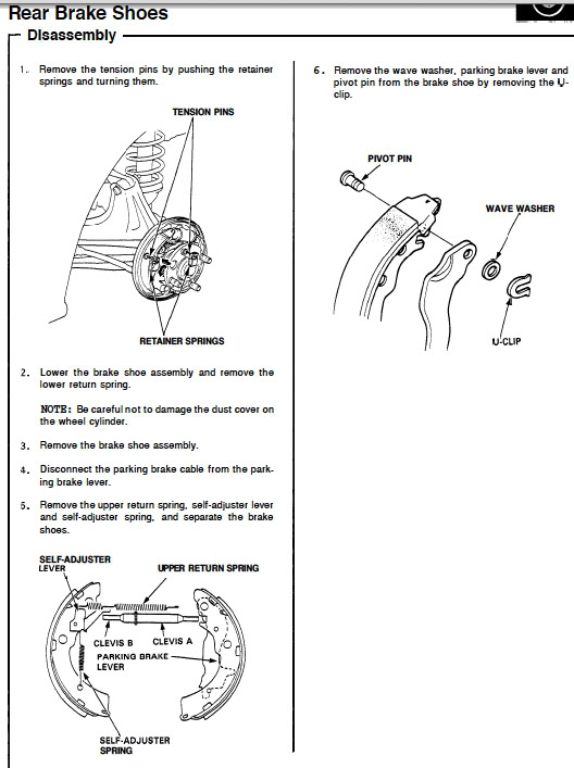

Block the front wheels and raise the rear end on stands. Remove the rear wheels. RELEASE THE PARKING BRAKE. If the rear drums don't just slip off with a bit of wiggling and tapping, each drum usually has two holes where an appropriate bolt can be screwed into to pop the drum off.
Now you can replace the rear pads (pain in the ars). For reference, see diagrams for 92-95 Civics below.
