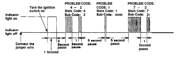

Edit -- I'm not sure what code you have. Here's how to read the code:
