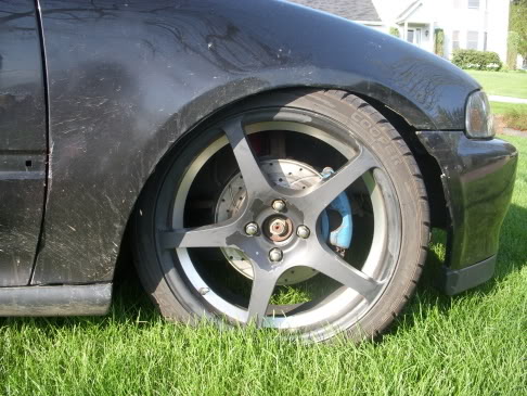

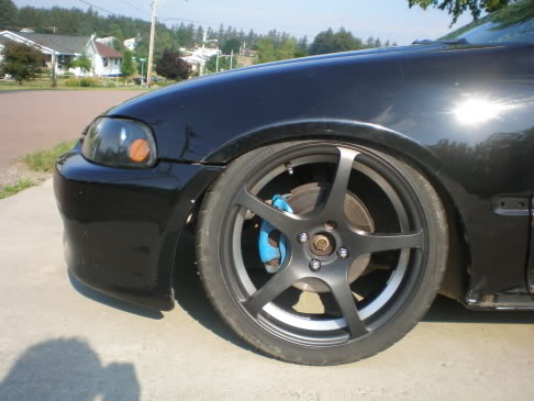

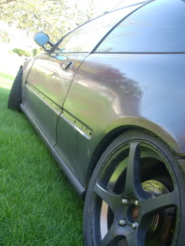

You know where the front strut sits down into the knuckle on the front suspension? If you take the bolts completely out, you can spread that part a little more, letting you force the strut down an additional fraction of an inch. You can also flip the threaded tubes upside-down letting you thread the spring perch down a little further (I'm not sure if you can do this in the rear or not, it's been a while since I toyed around with Honda suspension).
Or you can just remove the spring perches altogether like MBrent said.
Or you could swap the Godspeeds out for some Ground Controls. My old '94 EX sat on Ground Controls with KYB AGX struts and I was tucking all four corners without doing the two tweaks I mentioned earlier and without having the coilovers adjusted all the way down:
And with the fronts all the way down, no additional tweaks:
(205/40-17 tires, which means 3.228" of sidewall. I'd say a solid 3.1" of that is tucked in this pic )
Oh, and the only use a camber kit has when you're that low is adding additional negative camber. Once you're tucking tire, trying to get the camber more positive (more towards zero) will only ensure your tires and fenders have a territory dispute. I never bothered with camber kits on my old civic (I was running approximately -3.0° camber all around), I just had the toe adjusted to zero.
