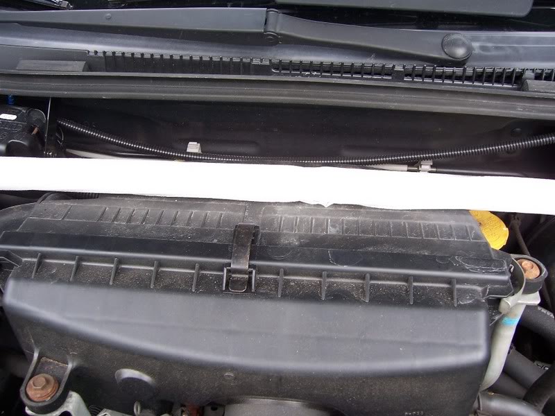

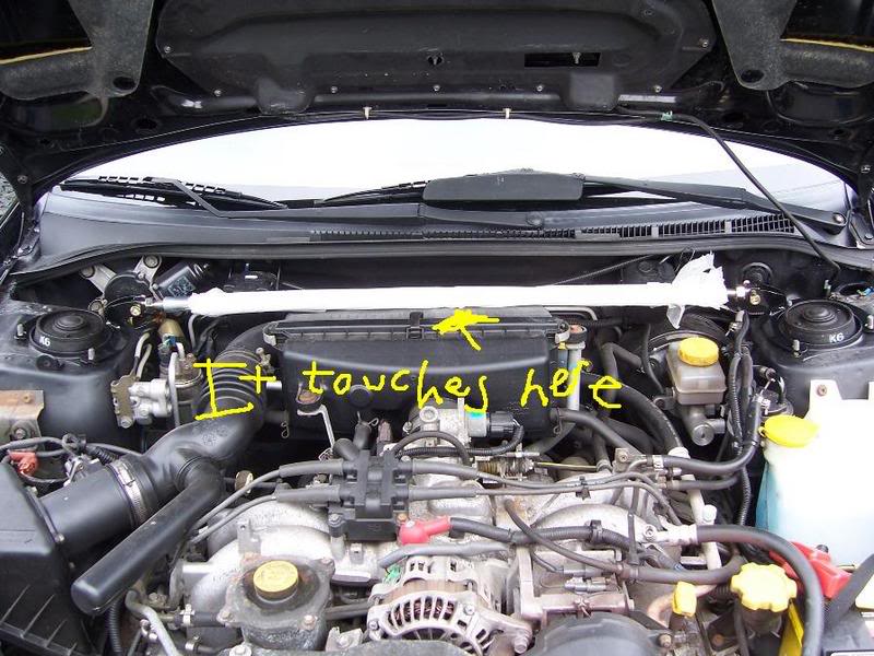

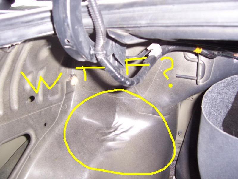

The strut bars came today and i pretty much got F'd over. The front one doesnt clear the airbox so i cant mount it. Dont worry, it gets worse. The mounting points are mysteriously missing in the trunk. I guess I just assumed they would be there like on the honda. BUT NOOO!!!!! stupid fuji heavy industries has to make it difficult. I pull back the trunk lining and all thats there is metal! I will get some pictures up later tonight.
EDIT: here they are. I guess its the price you pay for going with cheap ebay stuff. When you can buy 2 bars for under $40 I suppose you cant expect perfect. If there is something I am missing in the pictures please point it out.
Rear
Front

I have a feeling the rear mounts are under the rear parcel shelf and you're going to have to take half the damned car appart to get to um (was this way in my 02 intrepid and my ex's 98 saturn).........
On the front one all I can say is either mod the air box or get an intake ..... that or you could try bending the mounting arms upwards a bit or placing washers between the towers and the mount plates but I don't feel safe with that idea....

Yeah i just talked to some guys in my subaru club and i have to remove the back seat to mount that one. Front one i might end up bending or using as a towel rack in my bathroom.
