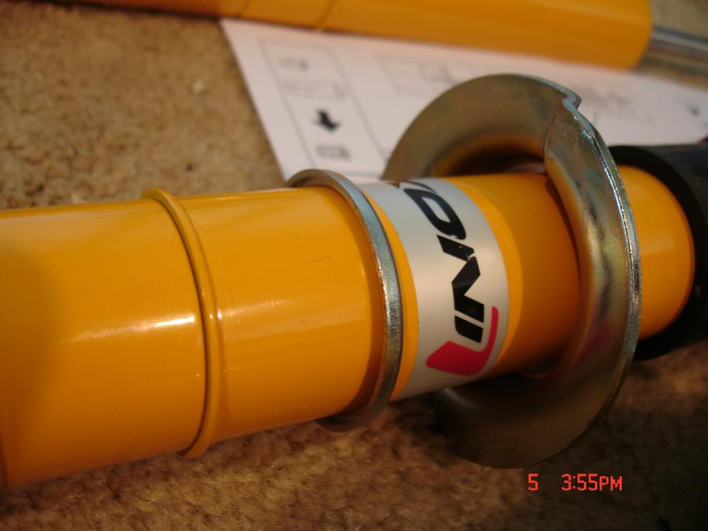

i havent used any of the silver rings from the KONIs only the already instaled Cclip thats painted...

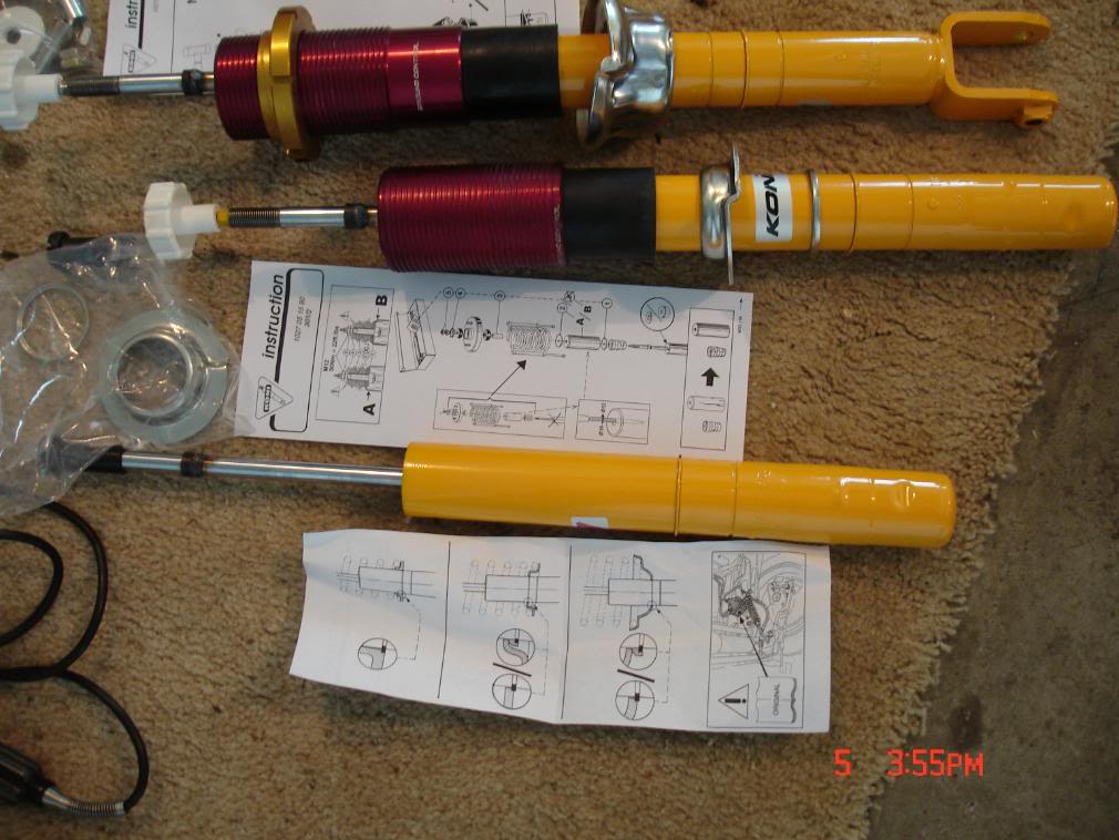

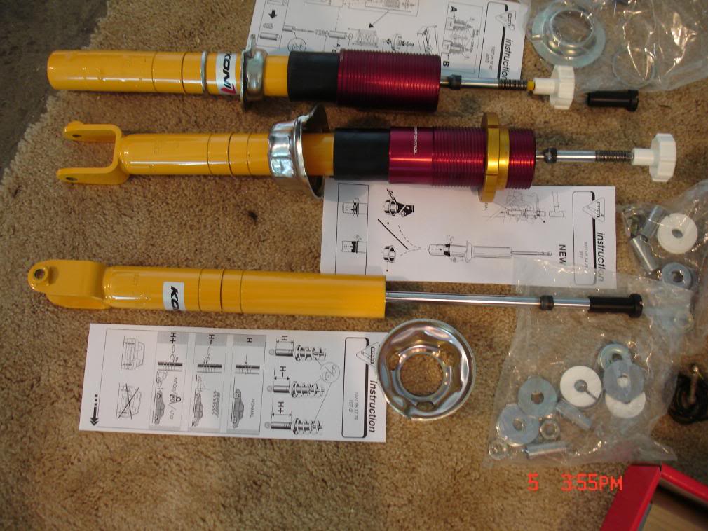

ok well JUST got my new koni struts but still waiting on my ground control replacement perches and bolts/ and orings.
PLEASE LET ME KNOW IF I NEED ANYTHING ELSE!

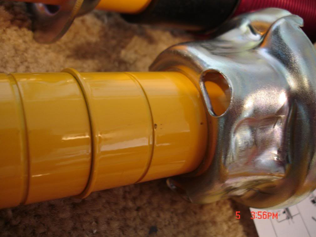

im just guessing how these should go on the struts.... my main concern is how the GC sit on the struts...
do i need a special ring for them to fit?

im more or less just curious if this is all i need..... besides the dust boots and bump stops and such stock parts....

You shouldn't need the silver spring perches, everything should fit snugly right on the shock body like THIS.
You're going to have to cut your dust boots down, and bore the hole out for it to fit over the Koni shaft. Also cut your bump stops if you haven't already.

so the GCs just use the rubber sleeve and orings to hold it above the clip? i just dont see how that could really hold the coilovers inplace....
ya mine came off a stock strut setup... so do i have to call and order the correct mount or something?
kinda hard to see your pictures where the struts meet the coilover... looks like there is the same thick rubber sleeve...

well CRAP.... ya they said i have to buy new red shafts to fit the konis....and i didnt know that when i ordered the other parts... (homer) DOOOOOOOPPPEE!!!!!!!!!!!!
