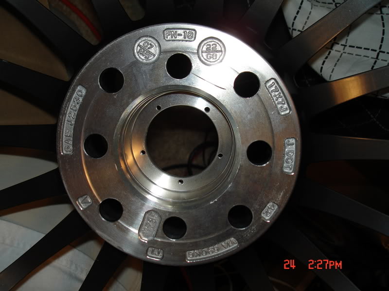

dito..... pull one wheel off and simply look at the back of the mounting point or the spokes.... they should have stampings on them...
like this...... my offset is 42
its got quite a bit of info stamped onto the rim.
