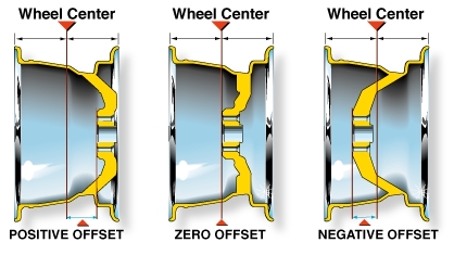

I just snagged this clip from the Club3G (Mitsubishi Eclipse Forum) that sums up offset pretty well.
Offset is the measured distance in millimeters between the centerline of the wheel and the hub mounting surface (where the wheel hub mounts up against the brake rotor/drum hub).
The basic principal behind offset is that all things being equal, the higher the offset the wheel is, the more tucked the wheel will be. The lower the offset, the farther the wheel will protrude.
Example: a 17x7" wheel with a +40 offset will protrude out an extra 15mm when compared to a 17x7" +55 offset wheel. In retrospect, the +55 offset 17x7 will be pushed 15mm closer into the wheel well when compared to the +40 offset 17x7".

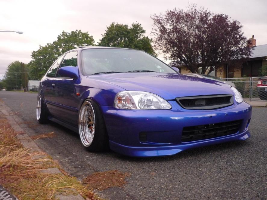

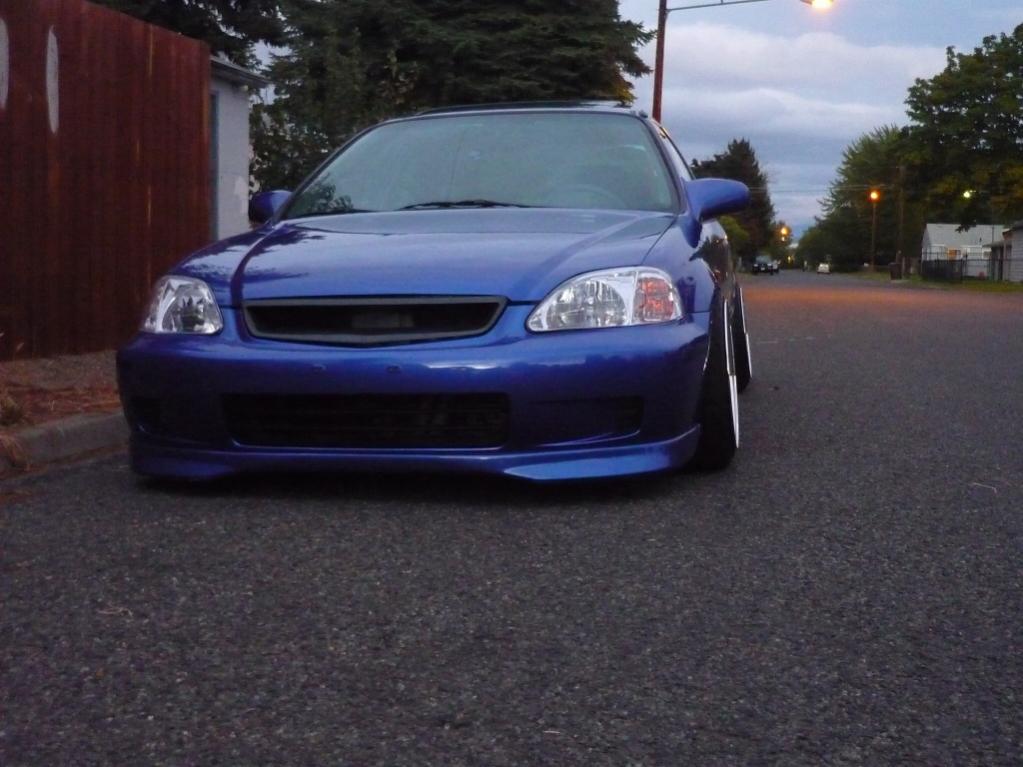

yes you could potentially fit a 15×7 0 offset but you will need your fenders rolled and utilise stretched tires like a 195/40/15 you will most likely also need negative camber in the rear.
for reference this is a 16×8 0 offset. also a offset diagram.
