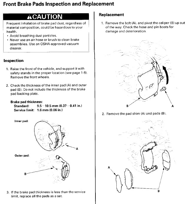

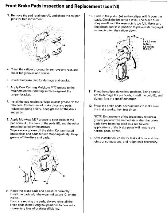

Replacing brake pads is a DIY job if you want to save some money. Put the front end on stands and remove the front wheels. You are nearly halfway done at this point. See diagrams below for remaining details.
