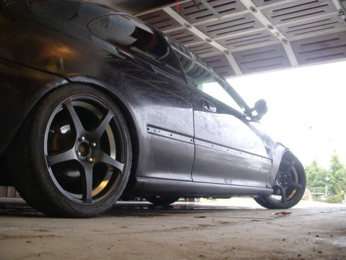

I've never seen negative camber mess up a wheel. However, camber wear on tires really depends on how much negative camber you have and how wide your tires are.
For example,
-3.0 degrees of camber on 205 tires. I didn't have any noticeable camber wear when I sold the wheels and tires 10,000 miles after lowering the car.

It was. I'm pretty sure the guy I sold it to raised it up... you should have seen his face when he came to see the car in person and realized just how low it was
Anyway, -3.0 degrees of camber is about my limit with MacPherson struts... any more not only looks terrible but would probably wear the tires. Just remember to get a 4-wheel toe alignment after you lower it... camber won't always kill tires, but it takes .1 degree of toe to ruin a tire.
